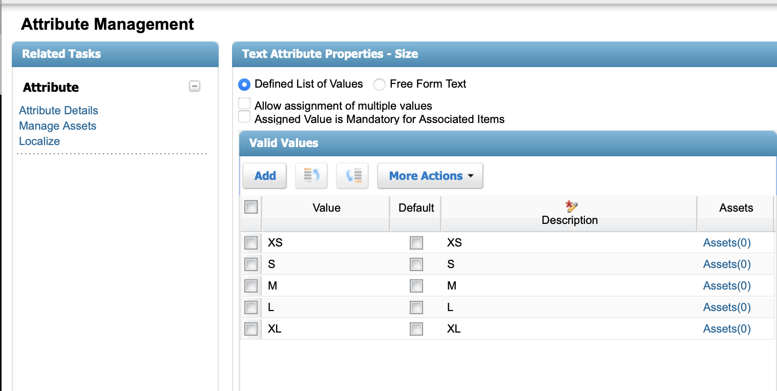

    While defining the variation attributes in SBC, we can give a sequence.

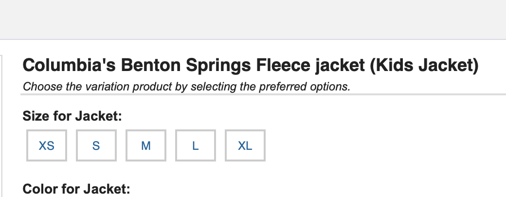

    Call Center UI displays the variation in that same sequence.
    For ex : If we define the attributes in the sequence of S, M , L then it would display in the same sequence in Call Center as well.
    Please find the below screenshots verifying the same.
    In SBC, for size there are five variations XS, S , M, L, XL. Its configured in the same format as mentioned.
    SBC Screenshot
    In Call Center the variation would be displayed in the similar sequence

    Even in Call center it would appear in the similar sequence as in SBC.
    In case if you are seeing issues in the sorting in Call Center, can you please check the attribute sequence in SBC and have the sequence updated to the way you need it to be displayed in the Call Center and verify if its working or not.
