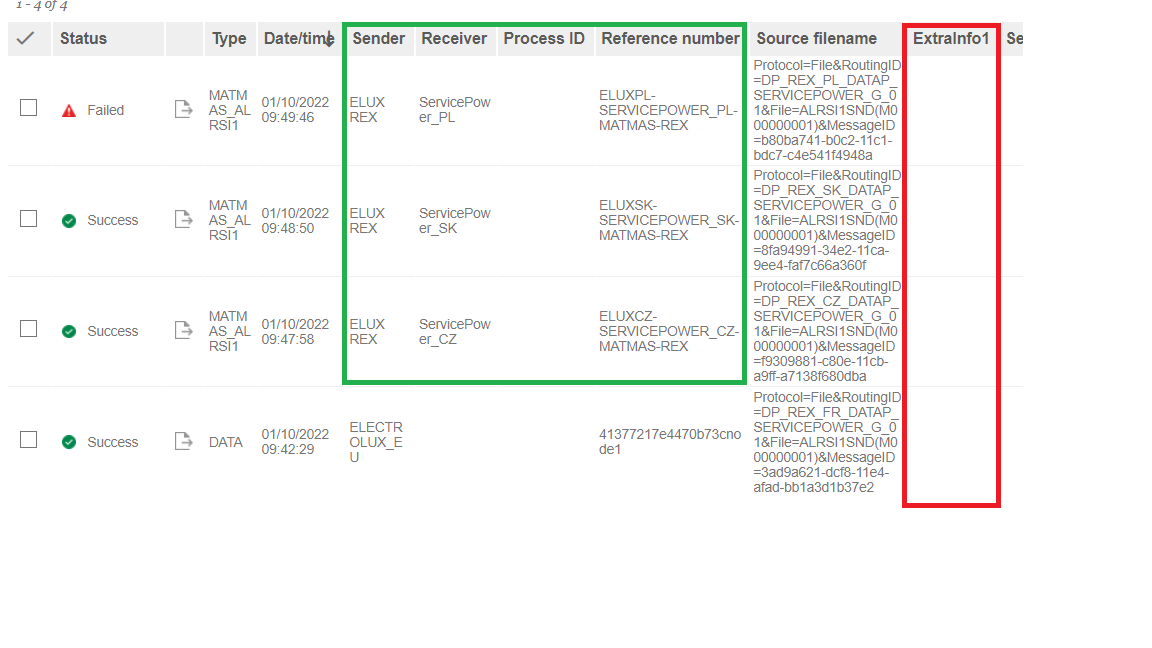

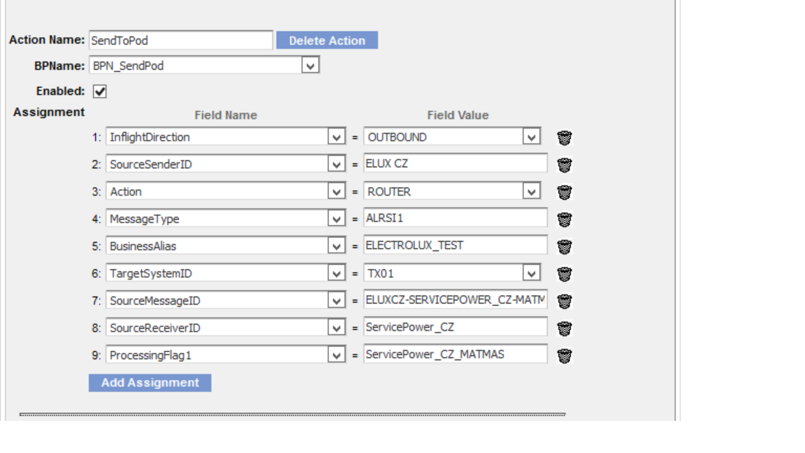

Update ExtraInfo1 Information using Rule Assignment to display in the Inflight document tracking
Currently, We can update sender/receiver/document type/reference number information using rule assignments to display in the Inflight document tracking. But we don't have any direct assignment in the rule to update ExtraInfo1 information. Currently, We are only using maps to update relevant ExtraInfo1 Xpath to update this information. For some of the flows, we have simple passthrough flows that were implemented using router rules ( without map ).

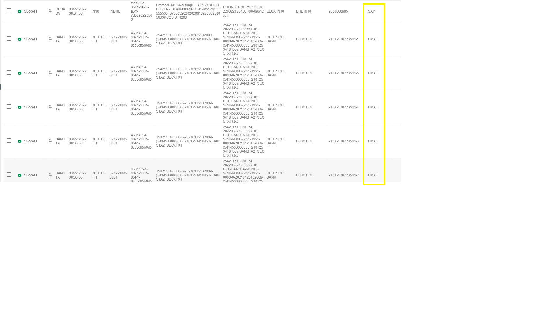

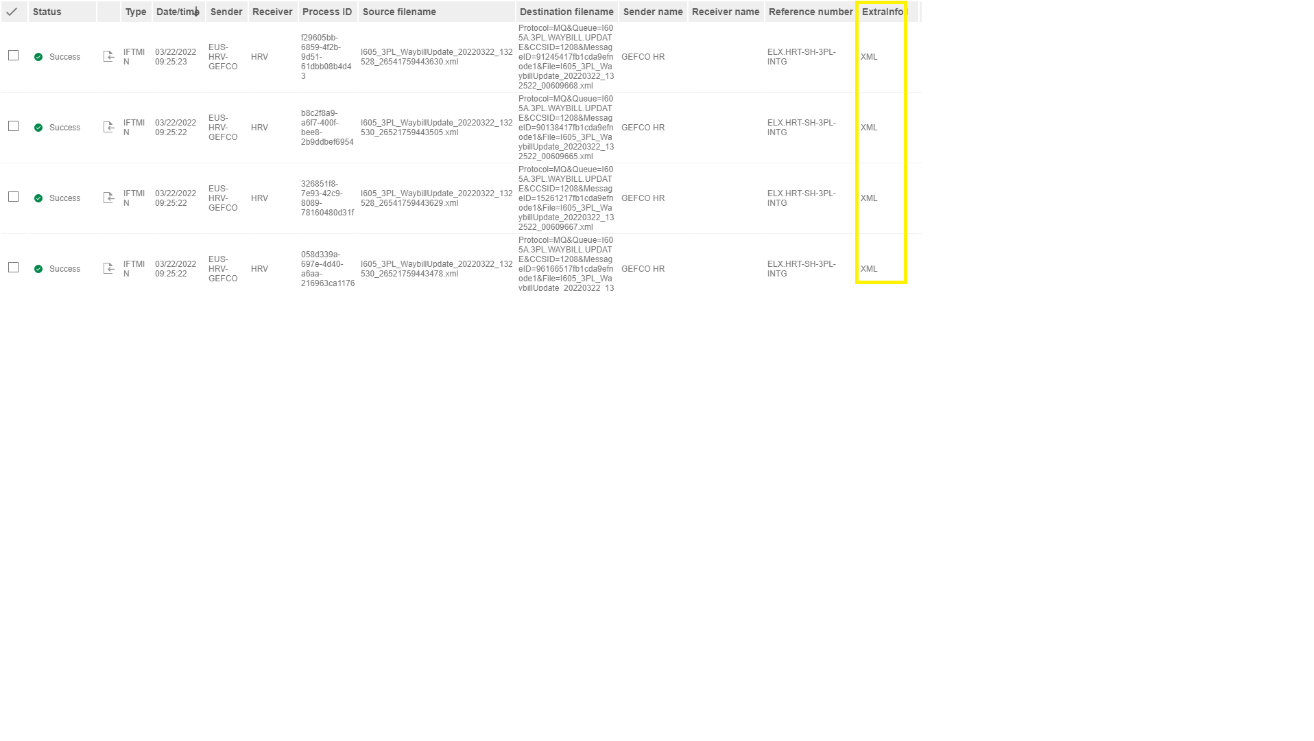

    Attached sample Inflight screenshot with ExtraInfo1 values.
  • Guest
    Mar 22, 2022
  • Guest
    Mar 22, 2022
    In my case, We want to update sub document type or additional tracking reference number or client internal partner codes etc.,
