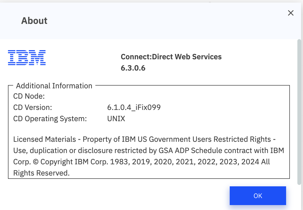

Connect Direct Web Services - API Method for Connect Direct Version
There is currently no API method available to retrieve or GET the Connect Direct Version using the REST API, although this is available the the CDWS Web Console (see attached image). Can this method be considered?
What is your industry? Banking
How will this idea be used?
It would be useful for retrieving version information for upgrades across multiple nodes with a simple API call.

    Mar 2, 2025
    Delivered in CDWS 6.3.0.9 with new version command: /cdwebconsole/svc/version:
    Version API is used to retrieve the version of the Web Console instance running on system.
    Thanks,
    James

    Mar 18, 2024
    We have an existing REST API for CDWS Sign-on which is inline with the RFE.
    Rest API URL :
    https://localhost:9443/cdwebconsole/svc/signon
    Host name : Ip Address or host name of the server where CDWS was deployed. 9443 : Port number on which CDWs is running
    Request Payload :
    Here we need to send CD server details
    "ipAddress": "172.20.186.67",
    "port": 1363,
    "protocol": "None"
    Protocol can be : None/TLS1.2/TLS1.3
    Response:
    "messageCode": 200,
    "message": "Signon is successful",
    "version": "6.2.0.23",
    "cdVersion": "6.3.0.1",
    "nodeMachineName": "CDWDEV-007",
    "osType": "Windows",
    "nodeName": "CDWDEV-007"
    cdversion is the version of CD node.
    Thanks,
    Product Management
